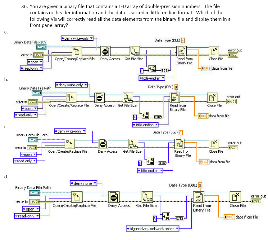

I think the Practice Exam Solution may be wrong.  FWIW, I picked B.  Exam solution claims the answer is A.  Aren't Doubles stored as 4-byte?

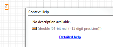

Thanks Jeff.
I guess I get confused with the layout of the Representation Palette.
Seeing U32, I32, and Double in the same column makes me think they are all 4 byte and that Extended is the 8 byte version.
Guess studying for the recert has made me learn something after all.
Doubles are 64 bit and Extended is machine dependent at least 64 bit.
(8,360 Views)
doubles are 8 bytes, singles are 4 bytes
