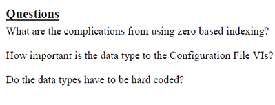

First of all, thanks for the great exercises.
As I was completing the exercises, I was wondering if there any answers/discussions to the
follow-up questions at the end of each exercise pdf files.
namely the one like this.
Message 22 of 30
(14,483 Views)
Hi doradorachan,
We have not documented exact answers to those questions. They are intended to make you think about your own solution and the provided solution. If there are specific questions you would like to discuss in more detail, I encourage you to post your questions on the forums -- I'm sure there are plenty of people who would be glad to help.
Cheers,
Daniel
