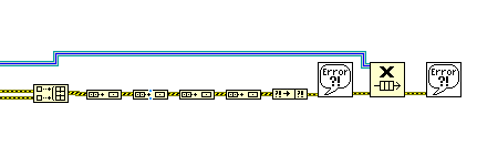

Hi, I would like to mention a (small) coding mistake in the solution of CLD 11. When you open the solution and navigate to the Error Check of the producer you see this:
2013-12-06 15_09_57-CLD 11 Producer consumer events solution.vi Block Diagram on CLD 11 Producer Con.png
So after a diagram cleanup of this section it expands to this:
2013-12-06 15_13_48-CLD 11 Producer consumer events solution.vi Block Diagram on CLD 11 Producer Con.png
I don't know what the intention of the original programmer was but I guess he/she mend this:
2013-12-06 15_16_00-CLD 11 Producer consumer events solution.vi Block Diagram on CLD 11 Producer Con.png
Edit: a bit nore scrolling to the right (error handler) gave me this beauty:
2013-12-06 15_20_33-CLD 11 Producer consumer events solution.vi Block Diagram on CLD 11 Producer Con.png

That is actually a conversion from the old Merge Error function.  If you look in the VI properties as soon as you open the VIs, you will see that they were written in LabVIEW 2009.  The new(er) Merge Error that expands and is way faster was done in 2010.
Ok that explains a lot since the error is twice in the VI and why they are alligned so nicely on the block diagram. It could be a idea to mention this in the "CLD success package users guide" so other users are aware of this.
However, next I'm wondering if the converter in LabVIEW shouldn't convert this to the 2012/2013 version instead of this strange edition.

@Cust_Cert_NI wrote:
That is a result of down converting as mentioned.   This occurs because we down copnvert theVI'sto , inthiscase, 2009.   Asapolicyforconvenienceto ourcustomersweprovidematerialsonlineinaversionthatisthreeversionsbehind.

Hi,  repost
That is a result of down converting as mentioned.   This occurs because we down covert theVI's to , in this case2009.   As policy for convenience to our customers we provide materials online in version that is three versions behind.
