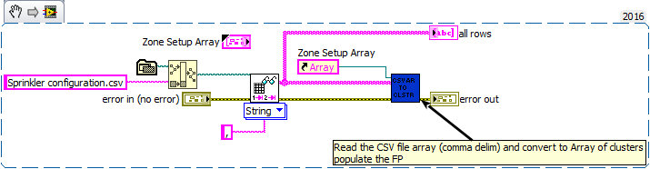

Another thing I do very often is create a reference for the FP control and use the reference throughout the code to populate the values on the fp control, obviously fp control ends up being unwired, is that wrong and most importantly would I loose points for this??
Message 63 of 68
(6,374 Views)
I don't know if you'll lose points but one thing you may want to consider is that if you do this too often it can be become difficult to figure out why some value is being written incorrectly to your front panel if references are all over your application. Writing values to property nodes is also ~1000x slower than just wiring it to the indicator which usually isn't noticable but it is something you should be aware of.

Thanks for replying!
Someone in this thread earlier has brought up loosing points for unwired controls, I will try going through the thread to find this post again.
"Control terminals on connector pane not wired on block diagram". - this was quoted.  Or is this the case where control terminals are added to subvis in a template-like fashion, but then never used?
That's why I would like to know if others have seen it and you loosepoints for this.  As far as the rest goes - see below
@Jacobson-ni wrote:
I understand this; however, I do this, for the sake of updating FP from SubVis, so clearly the subvis are where one would look.  Do you know of a better way?
Agreed on that, however, is it still ~1000 x slower, if you have to have a special case for updating the FP and WaitMs to execute?  Primarily I do this to perform methods on Controls, but indicators as well, when there's need to update them from a SubVi.
Message 65 of 68
(6,355 Views)
Rarely should GUIs be updated from subVIs.  1) It causes a lot of coupling. 2) It is slow.  So if you are just updating values, have the subVI pass out the value and write directly to the terminal.  If from a parallel loop, use a User Event to send the data to your GUI loop, which should be using an Event Structure already, and have the event case update the terminal.
