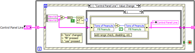

@DG76 wrote:
Unfortunately, writing to local variables in this context is simply not possible for this CLD exercise as far as I can tell. Has anyone actually tried it? I get the attached errors when I do.
If someone has in fact implemented this, I would be interested as to exactly how they did it.
My solution is still possible, but you need to change the buttons to "switch when pressed". Since you need to rewrite the cluster anyway, this gives you an opportunity to write a FALSE back to the booleans to simulate latch action. (However, I am not sure if changing the mechanical action is allowed).
Still, as many have said, this is not such a great example to begin with and the functionality could be implemented in a much more reasonable fashion by changing the entire template in a more suitable form.
I would probably start with something as follows (see picture). Note that you only need one event case for this. Status indicators not shown.
To expand, you would use an array of such clusters, for a fully scalable solution where you can change the number of plants by just changing the array size. You would first tell which element has changed, index it out using an IPE, process as shown with an unbundle IPE, and write it back to the same element. Use an array of status indicators for the display (not shown) .
