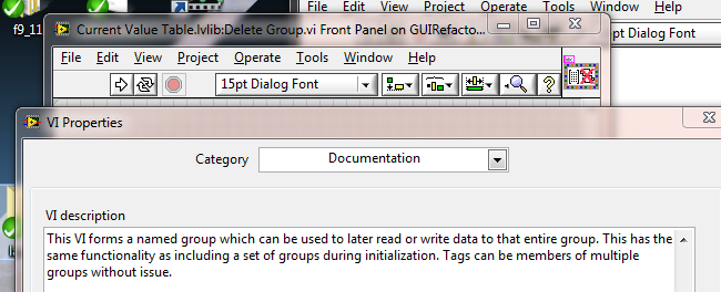

I've found a documentation error in the CVT. Not a big impact. Delete Group.vi seems to have the same documentation as Group Tags.vi:
Message 91 of 164
(11,003 Views)
Thanks, I've added that to the known issues list here:
https://decibel.ni.com/content/docs/DOC-37445

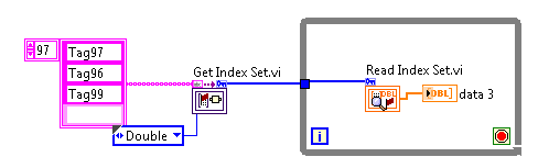

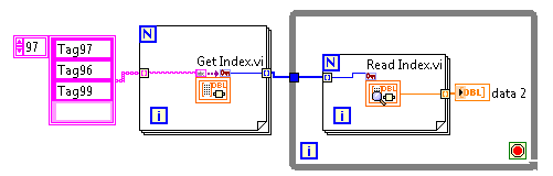

To clarify #1, it will probably make more sense if you download the API, but the basic idea is that you shouldn't do this for API-specific reasons:
The preferred mechanism is to do this, and perform the lookup before you go into the loop:
Since this is preferred, there are even VIs to do this:

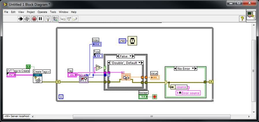

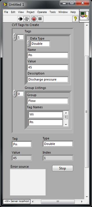

Hi Daniel,
I have had play about with the API and conceptually I understand what's going on, except for the aspect of extracting the CVT data from multiple VIs running on the same local machine. Asides using TCP/IP or UDP how else could the data be retrieved, because I "can't afford" to have a local server on the local host of the CVT? Any insights would be appreciated. If a PM is okay by you, I could send a bit of detail on the crux of the application I'm working on.
Ifeanyi
