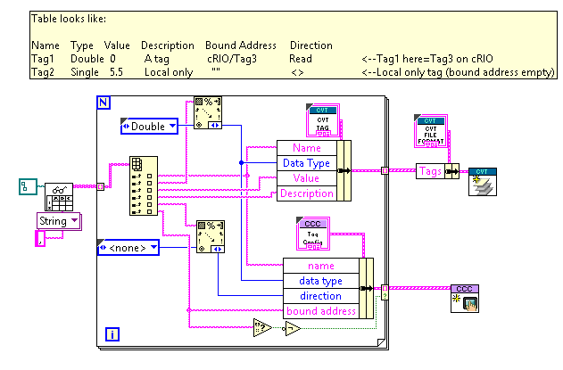

So there are two "tables". One is the runtime table, which is what the CVT API is accessing. There is one CVT per system. CCC is used to copy data from the CVT on system A into the CVT on system B. This is similar to the end result of using shared variables, but it tries to accomplish the task in what is arguably a more efficient way.
There is also a configuration "table" which is used to initialize the CVT API. This can be manipulated in any way that makes sense. Typically for two systems you'd see 3 sets of tags: HMI-only, RT-only, and shared. Shared tags are the ones you would be transferring using the CCC. However, the way the CCC works means that only the client (HMI) has to know that the tags are being shared.
Finally, you would ideally separate the view of the configuration from the storage of the configuration, which would allow you to initialize both APIs however they need to be initialized while still displaying to your user the data in a way that makes sense. But its typically easier to use excel or CSV files or a labview multi-column listbox to show all the information you need to show and so thats what people end up doing. One way to handle this on the runtime side (ie when you load up the CVT API), parsing one giant table and using empty spaces to indicate that a feature is not used:
Here, if Bound Address is empty, we assume it is not a CCC tag and so we don't add it to the array (conditional indexing).
