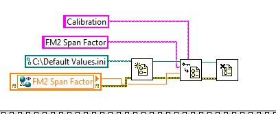

5)I notice you have a VI, inside of a loop, which does this in many places:
This by itelf is very expensive. Here is why: First, you open the file. Then, you read the whole file and load it into memory. Then you parse every single key-value pair out of that file (this parsing is robust but very slow). Then, you write a value into the table you loaded into memory. Then you reform that table of data into a file. Then you write your data to the file. Then you flush it to disk. Then you close the file. This appears to be happening as much as 5 times per loop. There is *no* way this is happening within your 100 ms timeframe. You should open your file during initialization and write to that fixed reference from the appropriate loop without having to reload everything.

Thanks for taking the time to look at my code, I know there is a lot to look over there. As you mention, I will start to look at different methods and check what can I improve taking in consideration the required time for the change. About the screenshot that you make reference above, it's true that I have it in a loop, but also inside a case structure and only will execute when the operator press a determined button on the HMI. Probably as you mention this is not the best approach, but is not like the code will execute every loop iteraction. I will also take a look  to the document that reference and make a research on the "AMC" that you mention. Thanks for the support, your advice look like another way to take some load from the processor. I feel that if I am able to compile all the sugestion that you guys make me I will be able to run smoothly from the cRIO without the need to upgrade it. But I am still a rookie and it will take me some time of research and learning to acomplish it.

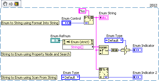

After performing more testing I realized that trying to squish an enum control with text to a string is not possible. My first fix just used a number instead of text string to correspond to each case, but this was difficult to add new cases. Now I just use send the message through an initialization cluster that is flattened to a string.

@Etarkleson wrote:
"...trying to squish an enum control with text to a string is not possible."
Eric,
If I hear you correctly, you say you cannot convert an enum into a string, but this is actually a simple matter. Converting back is also possible (see the snippet below). You should always typedef your enums, of course, which this quick example does not show.
Enum to String
Hope this helps,
Richard

Thanks Richard!
I was trying to use a flatten to string, without any luck.
