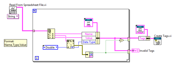

The new CVT is more efficient and has a few new APIs that can make your code a bit more performant or easier to read--and that performance can be a necessity when dealing with so many tags. If you are not using the CIE my immediate suggestion would be to keep using the TCE and simply load the old style format. Another good option is to use an excel/csv file. Tags are loaded in the form Name/Type/Value, and this is pretty easy to pull from a CSV. I've attached an example. If you don't have 2013, here is a screenshot:

Thanks for this explanation. It helps a lot. I think an excel style tag list may be better than the TCE anyways.
