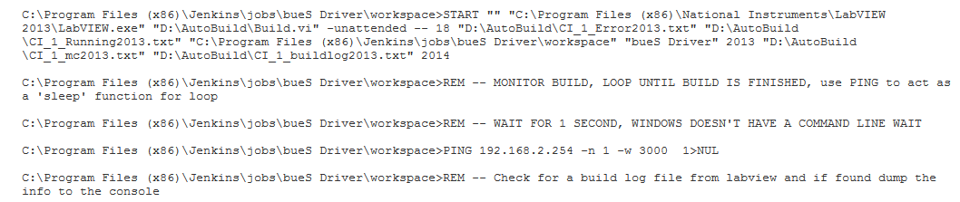

thanks for the suggestions
I think, my problem is even more basic: I have scrapped my modified LabVIEWBuld.bat and switched back to the original from github.
IMHO, LabVIEW does not start up at all! The console shows shows the execution of the START command (no error) and the waiting loop keeps running. But no LabVIEW process can be seen in the task manager with or without the unattended option.
Please find the screenshots attached.The error file you've mentioned is empty.
Using LabVIEW version on Autobuild.Bat call makes no difference.
So far I haven't tried any parallel builds, since I wanted to take steps one by one.
Addtional information: I copied the parameterized START command from Jenkins' command line display to paste and execute directly from command line: it runs out, LabVIEW starts!
Is there possibly an access permission issue with the start command of the batch?
Message 5 of 38
(15,077 Views)
