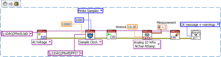

While I have your ear, I noticed that on one of my applicaitons, when I specified PFI7 for an external AI clock (via a 9401 in slot 5), I had to end the channel name with a slash.  The code errored when I did not have the slash.  Yet every other channel name didn't require the slash.  Any idea there?

I'm not really sure on the slash--do you mean you had to use the name "/cDAQ2Mod5/PFI7/" as the sample clock source?  The following code runs fine for me on DAQmx 9.0.2:

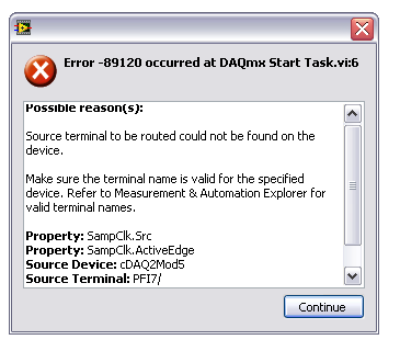

In fact, when I put a '/' at the end of the terminal name I receive the following error:
What error message are you seeing without the '/'?  Would it be possible to post a simple example like the one above that demonstrates the problem?
