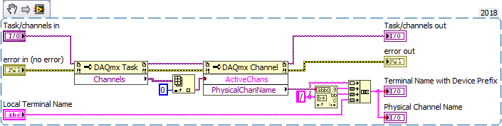

If I understand your description, here is a way to solve this task.
The code of the sub-VI that is used three times :
  • Configure the AI task to be triggered by the external signal. If needed, a start trigger can also be used.
  • Use the ai/SampleClock of the DAQ interface to trigger the CI task.
  • Both tasks must be on the same DAQ interface.
After the eventual start trigger, you will get 1 AI (for each channel) and 1 CI sample on each active edge of the external trigger.
Let me know if you need further help.
