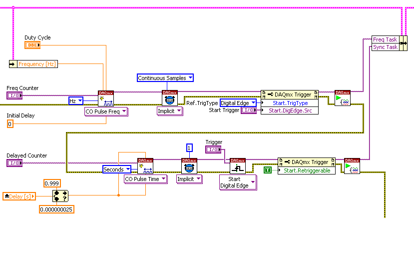

I didn't see where you're specifying the frequency of ctr0 in your code, the frequency terminal is unwired in the code you posted (it will default to 1 Hz):
My original code set ctr0 to pulse at the beginning of every cycle of the AO buffer.  To do this, I had to set the counter frequency to be equal to the (coerced) AO sample rate divided by the number of samples in the buffer.
Anyway, you can find more information about the clocks in the M Series user manual.  The Analog Output Timing section can be found on page 5-6, and the list of available signals to use with counters can be found on page 7-26.  In a counter output task, the output frequency is a divide-down of whatever signal is connected to the source (the driver will choose a timebase for you in most use cases).

John,
Good catch, I lost the Frequency specification on Cntr0 when I created that subset of code.  Yes, I'm specifiying the the frequency of Cntr0 to be that of the AO frequency.  See image below.
I reattached the corrected code.
