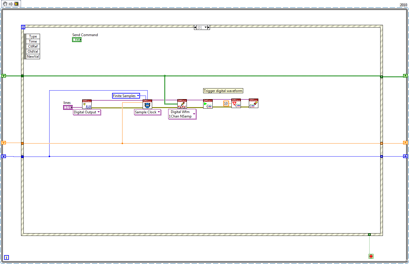

I finally managed to create a satisfying solution.
Here's digital waveform creation (data is first Manchester coded).
Here's pulse train sending
And front panel
This code is used in application, in which control commands (DALI forward frames) related to lighting controls are tested (standard iec62386).
Jukka
