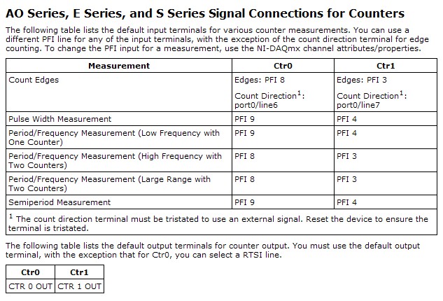

Your setup is correct.  However, it is not necessary to connect a +5V signal to the Ctr0-gate terminal.  The specific counter connections for your E series device are located in the NI-DAQmx Help:
