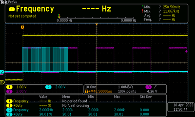

But nothing works. This gives two simultaneous output signals .... There is no delay between ... see attached jpg image ...
I would like to have a delay between the blue and the pink curve ....
Do you have an idea about the problem? a trigger statement?Sincerely 

A wait timer between two DAQmx Start VI has no effect if you configure the start trigger. The task is armed and ready to accept the trigger when DAQmx Start VI is called. It will only start outputting once it receives the start trigger. To set a delay between two counter output tasks, use Counter Output:Pulse:Frequency:Initial Delay Property.
