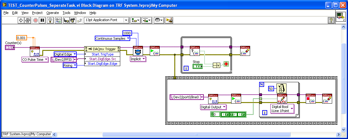

I can generate a pulse train on ctr0 and ctr1 individually or simultaneously starting upon a digital edge on PFI0. See the snapshot of the block digram below.
22974i11DBC211F2605781
As you can see, I trigger the task by writing to line0 which is connected to PFI0. As stated previously, this works as expected for both ctr0 and ctr1, however, I cannot get it to work for ANY other counter on the board! I need the task to start upon a trigger because I want multiple pulse trains to start EXACTLY at the same time. If you just start a multichannel task in software, each pulse train is slightly offset from the others.

Actually, I think this issue was reported as CAR #149610, "Committing a digital task (DI or DO) on any line on Port 0 on 660X stops pulse train generation on counters 2-7", which was fixed in NI-DAQmx 9.0. I tried out your code with a PXI-6602 and the latest version of NI-DAQmx. I'm not sure exactly what symptoms you were seeing, but with the newer DAQmx version, the VI did not produce any errors and the counter received a trigger from the DIO line.
By the way, it's also worth noting that in your code, the counter starts listening for a trigger on PFI0 before the DIO task has configured PFI0 as an output. This happens to work because PFI0 has a weak pull-down resistor, so it is low when tristated. If this was a different device type and trigger edge, or if PFI0 was connected to external circuitry, triggering on a tristated terminal could result in triggering early (i.e. before DAQmx Write is called).
