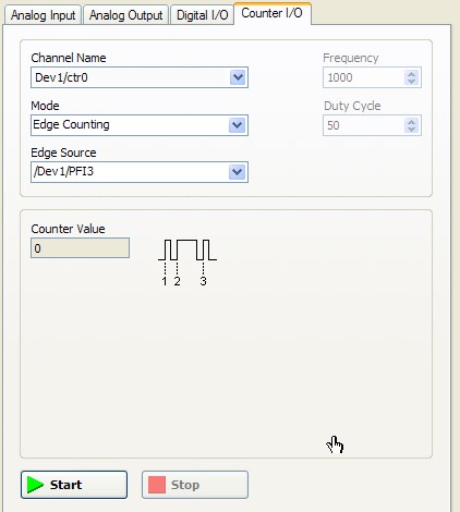

I'm uing PCI-6025E board and checked MAX can count DMI counter connected in /Dev1/PFI3 of ctr0.
But when I use DAQmxReadCounterU32 function in example code, it returns 0 of 'read' integer value but doesn't show the number of counting.

How can I read the DMI counting just like MAX does?
