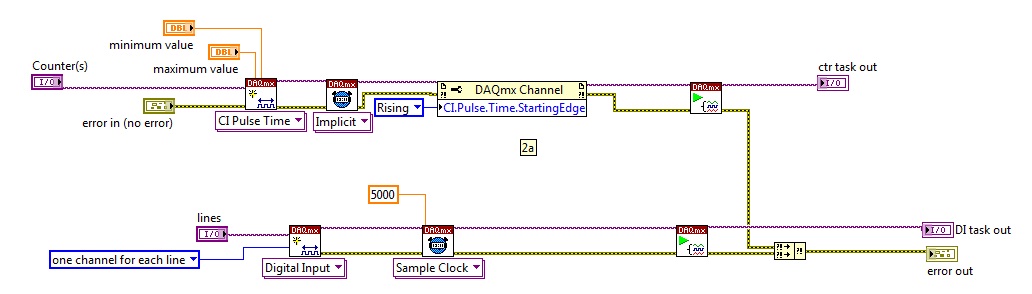

I want to acquire a PWM signal, measuring duty cycle with a counter measurement. To do so I use the CI Pulse Time version of DAQmx Create Channel and use Implicit timing. It works fine. (1)
Now, I want to add a DI task to read another digital input aside from the counter task , while still performing the above task. This new task is set on Port0/Line0 of my PCIe-6343. (2)
I was under the impression that the DI task will use its DI-specific timing engine as per X-series manual. However, when I run my acquisition the counter task only returns 0 as the Number of Samples Available and fails to read data.
Both tasks works fine individually, but I must be missing something else...

Since these functions work on an individual basis but not when wired within the same VI it is possible that the timers are interfering with one another.  On your DAQmx Create Channel for you counter measurement try changing CI Pulse Time to CI Pulse Ticks and adding the 20MHz Clock as your Source of Ticks.  This will allow your DAQmx Create Channel to reference a different time source.

Marcus,
The addition of the timer does not do the trick. Would it be a bug with Daqmx adn X-series?
I am using buffered  DI, but initially I was just doing a simple software DI which was all I needed. In any case, the issue is still here.
Can you reproduce the issue on a X card, a M card?
I am attaching a small VI that shows what does not work.

I have found a NI 6343 and have tested it to see if it can simultaneously measure the high time and low time of a signal while reading in another digital input.  I did find that this was possible on my NI 6343.  When I tested the functionality of this board I did not use the implicit timer or start task for the high time and low time measurement.  I also left out the property nodes and case structures to make it less complex.  I would suggest building this program as simple as possible to ensure it works before you add any additional features.
