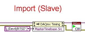

However, it is true that your application does not currently share the master timebase. If you would like to share the master timebase to synchronize both systems, you can export the signal to RTSI7 from the master system and import RTSI7 to the master timebase of the slave system. I have attached images of how your would export and import the signal.
One problem with this setup is that there will most likely be some delay between the master timebase signal on the master device and the signal that arrives at RTSI7 on the slave device. This delay can be attributed to the wiring you will have to use to connect the two separate systems. Additionally, depending on how you connect the systems, outside sources could induce noise on this clock signal that could affect the timing of your application. These are considerations that you will have to take into account if you choose to use the RTSI lines to route the master timebase.

Thank you Matt, Now I  understand the use of DAQmx and counter card more than the beginning,I will try as your advice.Now I can route 20MHz timebase to RTSI7 with no error and can import RTSI to mastertimebase with no error in 1 PC,I will try to test on 2 PC and I think it will be fine with no error too.
