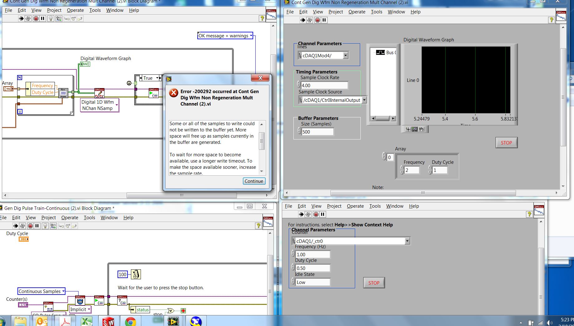

John,
I sense your frustration but really appreciate your patience.
I tried what you suggest  and the 9472 DIO4 began to flash.  Then I got this error.  Any suggestions

Sorry it came across that way, I don't mind at all.
You're really close--the problem is that the digital output task is writing a buffer of 500 samples but the counter task is only generating at 1 Hz.  So once the buffer is full it would take 500 seconds for space to become available (and the default write timeout I believe is 10 seconds... but you don't want your program blocking this long anyway probably).
You'll likely want your counter output to run much faster than 1 Hz (a higher frequency will give you more resolution on your PWM).  Pick an appropriate buffer size depending on the sample rate you choose--a larger buffer will make the program more robust in terms of avoiding underflow but will increase the control loop time.
Best Regards,
John Passiak
