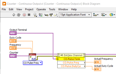

PFI lines are multipurpose programmable function input/outputs. You can specify any PFI as the output terminal for your counter.

Thank you!
