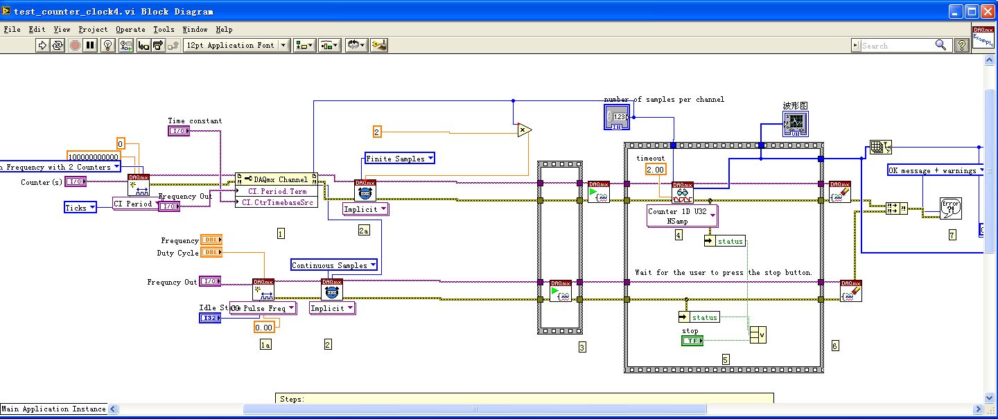

    Actually I tried but it won't work, and generate a pulse generation related error. So I modified the original program. It is ideal if the trigger generation-period counting method can work.
     Here is the code I tried as you recommended. The erroe -200284 pops up again. I tried using different timebase but that won't work either. I also tried using one counter or 2 counters, but they won't solve the problem.
     If you can, please help us to run the code on your side and see why it won't work as we planned. Thank you!

Hi xipeng,
The "Frequency" input of your CO Pulse Freq task is not wired.  It is defaulting to a low frequency and thus the clock is not producing enough samples quickly enough.
