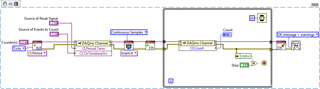

Hi Dan,
I was thinking something like the attached code for the acquisition task.  It's not quite as straightforward as running a shipping example but it should get the job done.
The source of the reset signal could be any number of things:
1.  Counter Output (HW Timed)
2.  Static Digital Output (SW Timed)
3.  Any External TTL Signal
Best Regards,
John
*Edit--the Implicit timing means that the data will be clocked-in after each reset--you can read the buffer back if you wish by calling DAQmx Read (you can manually set the buffer size with DAQmx Configure Input Buffer.vi).
Message Edited by John P on 05-13-2010 02:51 PM
John Passiak
(10,347 Views)
I re-read your original post and it sounds like you want to measure counts per second.  If so, you could replace the Property Node inside the loop with DAQmx Read (1 sample).  You would use another counter to generate a 1 Hz signal to use as the "Reset" signal.  This signal is what latches the value of the counter to your software buffer (due the Implicit timing configuration).
