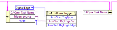

I am currently trying to aquire data from an analog input task (pressure sensors conncected to a NI 9205) and a counter input task (measuring flange for angle measurements on a NI 9411) in sync. I use the ai timebase of my analog task as a source for the sample clock of the counter input task for that. Since the counter input task is an optional feature of the data aquisition the syncing might be questionable but that is a topic for another day and the aquisition seems to be working fine for that.
Now i have a reference signal for my measuring flange, which will send a signal per revolution and want to start my measurement of the analog and counter task, when the signal has been detected. What I've done is using a start trigger with the DAQmx Start Trigger API for the analog task and a ArmTrigger for the counter using the PFI line the trigger is sent to.
However when doing this the tasks do not seem to start at the same time, since the samples in the buffer for both tasks differ immensely and when writing the data to a tdms file the number of samples for a rate of 40 kHz differ by ~6000 samples.
Now i am unsure if this is a problem with my QMH Framework or if I am misunderstanding how syncing the tasks actually works when working with triggers.
Currently I do not make sure that the Counter Tasks starts before the Analog task which was propositioned by Kevin [here], however I am unsure if this will fix the problem entirely, since when looking into it, it seems to me that the counter starts before the analog task. Thats why I wanted to ask if i even need the ArmTrigger for the counter task, if I use the timing source of the analog task and the trigger to start it and make sure the counter starts before the analog task?
Or if it is better to use the ai/StartTrigger source for the ArmTrigger to not have a delay?

Several things to start, and expecting discussion to continue.
1. Using the analog task's timebase as a source from which to derive your counter task's sample clock is probably a more complicated approach than necessary, and easier to get subtly wrong.  I see that my old msg you linked may have steered you in that direction though.  What I *didn't* elaborate on in that old msg is that a timebase is often shared implicitly and indirectly rather than explicitly and directly.  My main emphasis was intended to be that all tasks should ultimately derive their timing from one and only one master timing source.  Quite often that can be the (derived) sample clock from a designated master task which is shared and used by the dependent tasks as their own sample clock.
    In such an arrangement, all tasks ultimately derive their timing from the timebase used to set the master task's sample clock.  Thus they "share" the timebase.
2.  Lack of sync for your triggering situation *could be* a case where the AI task and the Ctr task are being triggered on different revs of the 1-per-rev signal.  This can be fixed, but there are other possible causes too.  One is that the 9205 uses a Delta Sigma converter for AI, which puts a filter delay into the AI data stream.
3. A first relatively simple approach to try:
- continue to configure the AI task to use the 1-per-rev signal as a Start trigger
- for now, don't bother setting up an Arm Start trigger for the counter task
- configure the counter task to use the AI task's *Sample Clock" (not the timebase) as its own sample clock.
- yes, be sure to start the counter task *before* starting the AI task
Neither task will sample until the AI task is triggered, starting up the AI Sample Clock.  The first counter sample is likely to be non-zero, tracking movement from the time the counter task is started until the AI task generates its first sample clock pulse.  It's likely that the first AI sample represents an AI signal value from a short time in the past due to the Delta Sigma filter delay.  You can compensate for this if you need to, but your post suggests that's not a big concern.  At least not yet.
-Kevin P
(372 Views)

I think as you've mentioned the problem is that the counter task received its trigger at a different point in time than the analog task due to how i set it up with the ArmTrigger. Which is why i removed it.

As for the solution to my problem:
Your suggestion with removing the trigger for the counter seems to work. Will mark your post before as solution therefore.
