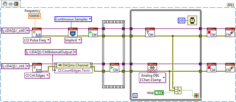

The counters on the cDAQ chassis backplane may be used to generate signals for internal routing without the use of any modules.  The way I read your post you are probably looking for something along the lines of this (i.e. generate a 500 kHz signal to be counted):
One could also interpret your question as if you were asking to sample the count register at 500 kHz (i.e. using 500 kHz as the sample clock rather than the source of edges to be counted).  This route would also be possible (although if you are on the older 9172 chassis I don't believe that the 2 sample FIFO will allow you to sustain transfers at 500 kHz--the newer chassis should work for this if this is what you actually want to do).
