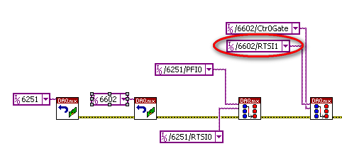

I'm trying to route a signal from a PXI-6251 PFI line to the Gate of a counter (PCI-6602) for pulse width and period measurements.  When I add in the connect terminals VI, I get error code -89126: Trigger line requested could not be reserved because it is already in use.  The documentation for the PXI-6602 says I can route directly from the RTSI bus to the gate of a counter.  I'm not sure why this conflict is happening.
Attached is a VI showing my setup and jpg of the error I'm seeing.  No error shows up until it hits the DAQmx Read VI.

The recommended way of making your connection would be to allow the driver to automatically configure the route for you.  You can accomplish this by making the following changes to your code.
Also, I tested your original code with a PCI-6221 and a PCI-6602 and got it working after making the following change.
You were previously trying to connect the RTSI0 Line from the 6251 to the CTR Gate on the 6602, when in fact you should be connecting the RTSI0 Line from the 6602 to the CTR Gate on the 6602.
Either way is an acceptable, but the first the recommended method.  Have a great weekend.

I originally tried to go directly from the 6251 to the 6251 (which is actually a 6289 which is a loaner due to my 6251 being out for repairs) without specifying the RTSI line at all.  That didn't work.  I then went to my config with same error.  I also tried your config, same error.  There is never an error with the connect VIs, only when the measurement tries to get executed with the DAQMX VI.  seems like if the connection wasn't being made, the connection VI should flag a problem.
So, the error persists even after the change you recommended.  Any other thoughts???

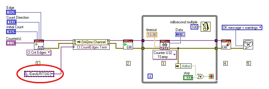

This can be accomplished by using property nodes to tell DAQmx to use the RTSI0 as the counter source.
I started by exporting an arbitrary signal out of my DAQ card and into my 6602 card.
In this case I exported my Analog Input Sample clock.
Next I modified the Count Digital Events.vi example to specify the input terminal of the counter to be RTSI0 (on the 6602).
I then ran my program and everything worked as expected.  Also, make sure the Counter(s) control is set to a specified counter.  I set mine to Dev6/ctr0.
NOTE: Since I exported my Analog Input Sample clock I had to have an Analog Input task running to start the clock.  In your case this can be any digital TTL signal.
I hope this helps!
