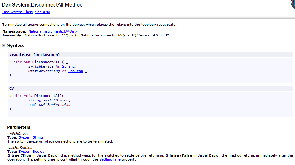

My question was how to use DaqSystem.Local.DisconnectAll(var1, var2), because I can't find any documentation for it.
So I found out another solution, but I'm still qurious how/where I can find information on DaqMx methods. Is the DaqSystem.Local.DisconnectAll() method documented somewhere?

The .NET help should be installed locally to your computer, you can find it by navigating to Start » All Programs » National Instruments » NI-DAQ » Text-Based Code Support
Here's a screenshot from the help for the particular method you were asking about:
This particular method is actually only used on some of the switch modules that work under DAQmx and doesn't apply to your 6229.
