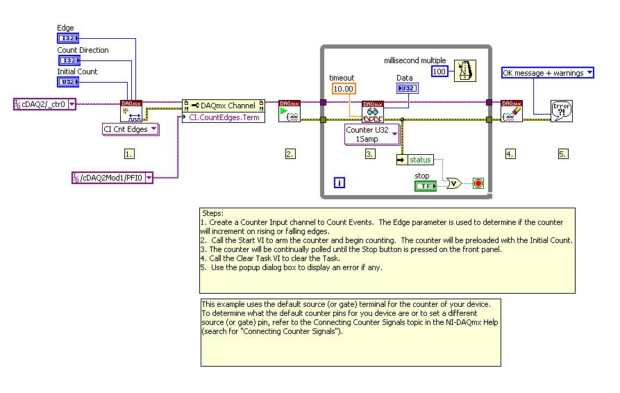

Hi Rahul,
I want to correct my previous statement.  I believe that the following example will show you how to perform a counter task with the 9205.
Jim Schwartz
