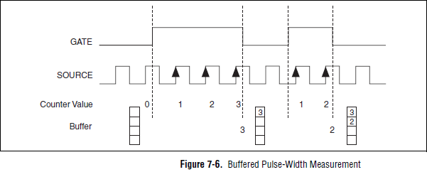

Great question.  You can't use a Sample Clock and Pause Trigger on the 6259 at the same time (they both use the same pin on the counter chip).  What you would want to do is configure a buffered Pulse Width Measurement (see diagram from M Series User Manual😞
It's not necessarily the most intuitive, but you would need to use the external gate signal as the pulse signal to be measured.  You can measure this in terms of ticks of an external "timebase" (in this case, your photon counter).  Configuring "Implicit" timing means that the value of every pulse will be latched in to a buffer.

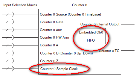

All X Series boards do allow the use of both a sample clock and pause trigger.  The reason is that they have a dedicated pin on their counter chip for a sample clock input (M Series and earlier boards used the Gate input for the sample clock).  The gate input is used to implement the pause trigger.  See the following image from the X Series User Manual:
The items circled in Red are unique to X Series boards and are not present on M Series.  The FIFO allows us to sample X Series counters at a faster rate than other boards (10 MHz or so per counter).
The buffered Pulse Width Measurement approach depends on you sampling the count register at the falling edge of every gate signal.  It sounded like your gate signal is 1 MHz, which would be too fast for M Series counters.  If you slow the gate signal down to the 380 kHz range then this method should work on your M Series.  The setup code would look something like this:

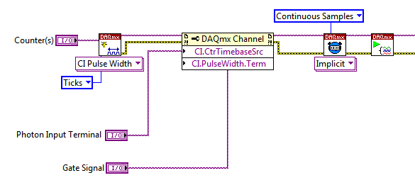

If you configure your device like the following it should work (just tested on a PCIe-6353):
In my case, PFI8 was connected to an encoder that I manually rotated to produce pulses, and PFI0 was connected to a button which would pulse low to reset the gate signal.  I was able to report cases of 0 encoder pulses during the gate.
If you're configuring the hardware differently then you might encounter errors.  Make sure you have Implicit Timing selected from the polymorphic VI and that you are using the same terminal names that I am for your signals (CI.CtrTimebaseSrc for the photons, and CI.PulseWidth.Term for the gate).  If you had an external sample clock configured (instead of using imlpicit timing) then you might get errors if you receive two consecutive clock edges without a pulse width (which is actually the gate), but this probably isn't what you want to be doing anyway.
