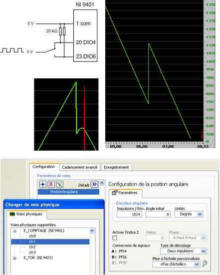

I send this message because I have a problem with a counter on an NI 9401on cDAQ-9178.
I measure an angular position with two pulse signals (increment on channel A and decrement  on channel B). There is one signal and it is a relay that directs the signal to channel A or B.
You can see details on the attached file.
I purchased a sample of the counter every 10ms.
Everything works fine except when an AC motor of the machine starts or stops.
When the AC motor starts or stops the counter value change by an offset (see attached file). If the counter is counting, I observe a negative offset. If the counter is counting down, I see a positive offset.
If they are electrical noises, why will not offset in the direction of signal?
How to fix the problem?
Thank you for your help.

It sounds likely that you are picking up electrical noise.  The noise would be picked up more on the disconnected channel since it is not being driven by a low impedance source.
Based on your attached graphs, the noise appears to be a fast series of several short pulses that are much shorter than the pulses that you are intending to measure.  If so, digital filtering might be a good solution as you can choose to reject pulses below a certain width--you should be able to find a cutoff such that the fast glitchy noise pulses are ignored but the longer steady encoder pulses are accepted.  Digital filtering is only available starting with DAQmx 9.4 for the 9178.  However, you can't use digital filtering in the DAQ Assistant.  You would need to use the DAQmx API in a programming language such as LabVIEW, C/C++, or .NET.
If you are open to changing your external connections, the undriven PFI line could be grounded instead of left floating (you would probably need a different type of switch) which would hopefully remove the noise altogether.  Before changing your switch, you can test out this possible solution by connecting one of the lines to your signal source, the other to ground, and turning on your motor to see if the noise goes away.

Think you John,
After some modifications, the problem has evolved. Now the offset signal (noise) is only on the signal connected.
I'm downloading the NI-DAQmx version 9.40 to apply digital filtering on counting.

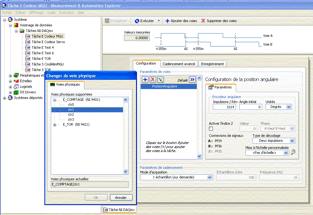

The filter should be set in MAX or in LabVIEW? (my program uses Labview tasks set in Max).
Could you give me more details on the configuration of the filter on the counter. (on image, the configuration of my task with DAQmx 9.2.3

Hi BGR72,
Unfortunately you can't set the filtering directly from MAX.  You'll have to use one of the lower level APIs to enable it.  As an example, in LabVIEW you would just need to set the following properties before starting your task:
The minimum pulse width would depend on the characteristics of the noise you are picking up as well as the pulse width of your actual encoder pulses.  You want the minimum pulse width to be wide enough to block all of the noise, but short enough to guarantee the passing of the encoder pulses.
