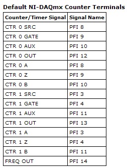

Great question.  The following screenshot will give you the Counter/Timer Signal associated with its respective PFI line:
This table can be found in the NI-DAQmx help (NI-DAQmx Device Terminals Help » NI USB-6259 BNC).
To access these PFI lines from one of the user-defined BNC (User 1 and User 2), wire the desired PFI line to the desired User line.  For example, if I wanted to access Counter 0 Out from the User 1 BNC, I would wire the USER 1 pin to the PFI 12 pin.  The USB-6259 BNC specifications manual doesn't give a good description of how to access the User 1 and User 2 BNCs, so I would refer to page 9 of the user manual of the BNC-2110.  It's the same basic concept, just different pin-outs.
