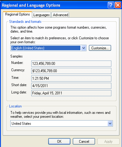

We think that this bug is caused by a formatting issue with the input "number format" of the "read all sheets.vi" and the "regional and language options" differences in windows between Germany and the United States.
We will keep you up to date about the solution to this problem!
In the meanwhile if you found a way to make it work untill XLR8 2.1 please post it here for customers with a similiar issue.
