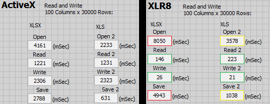

Since XLR8 has been touted as faster than Active X, I wanted to know how much faster it was, so I setup a simple LabVIEW read and write check to the same spreadsheet (100 columns x 10000 rows), that already had the two sheets created.  It appears though, that the Active X is faster.  If you could, please take a look at the attached code (LV 2013 SP1 tested on Windows 7).  Please tell me how I can speed up the XLR8 code if possible.
Granted, nominally I would be reading and writing to a 50 columns x 100 rows spreadsheet, but I would like to know under what circumstances that the XLR8 approach is faster.  We would like to sunset the use of ActiveX, but I was hoping that the speed increase would be the extra icing on the cake.

Hi Karl,
thanks for your patience!
I did some research about the speed difference between Active X and XLR8.
As my college said the xlsx format is currently optimized for stablity and not performance.
The new Beta Version (2.1.0.6) of XLR8 which you can download in the document section got some performance improvements in opening, saving and closing the workbook. Feel Free to test the new Beta Version!
To show you the results I used your provided VI and just duplicated the code to test the performance for
.xlsx and .xls. I also changed the rows from 10.000 to 30.000 to see the difference more clearly. Additionally I changed the indicators to (Open, Read, Write and Close).
The result shows that the perfomance in reading and writing data is much more faster than with Active X.
Open and Saving/Closing the Template in .xls is a little bit more slower compared to Active X.
Open and Saving/Closing the Template in .xlsx is slower compared to Active X.
If you have any more questions just write us!
