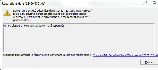

XLR8: delete sheet don't remove named range of the sheet
Result:
- error (1172) in "Create Named Range" on the new page with the same name of previously delete page
Error
Error 1172 occurred at Property Node (Arg :1) Error accessing property NPOI.SS.UserModel.IName.NameName, (System.Reflection.TargetInvocationException: Exception has been thrown by the target of an invocation.
          Inner Exception: System.ArgumentException: The workbook already contains this name: CHECK)
Possible reason(s):
LabVIEW:  A .NET exception occurred in an external assembly. For information about correcting this error, copy the following exception (in bold), and search the Microsoft Developer Network (MSDN) Web site or the Web for a possible explanation.
System.ArgumentException in XLR8.lvlib:Create Named Range.vi->Fenetre rapport.vi
- Excel generates an Error at file open
Solutions:
- add VI to remove selected or all Named Range. (also usefull with a Wipe Sheet)
(5,397 Views)
hi daniel,
thanks for reporting that bug! I checked it with the old xls format and you are right! The xlsx format doesn´t have this bug. It will be fixed for xls in the next version of XLR8!
Greetings
Hajo
