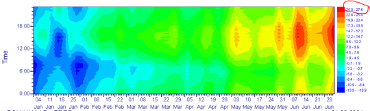

I report temperature data over 6 month in a 3D diagramm like this
The temperature is shown on the z axis.
The class of the color legend is  given automatically. (-13.5/-10.9, -10.9/-8.4,...., 25/27.6)
Is it possible to choose the number and the range of the color legend class (for example -15/-12.5, -12.5/10, ... 25/27.5, 27.5/30) ?

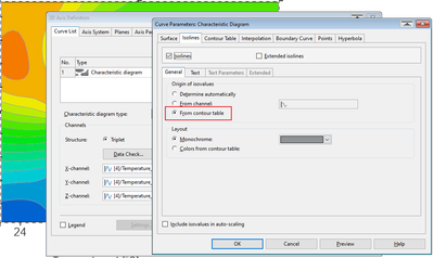

If you use the 3D type “Surface”, then you only have the options of “Color Palettes” and an exact definition for the ranges is not possible.

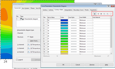

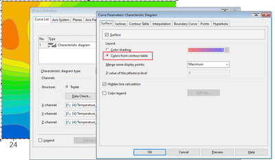

In case you use the “Characteristic diagram” you can specify certain ranges in the “Contour table”

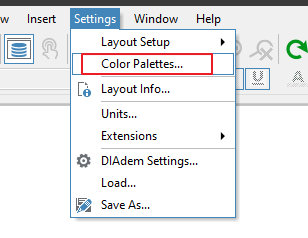

Change the color palette is not the solution because, other diagram with oder range are impacted...
