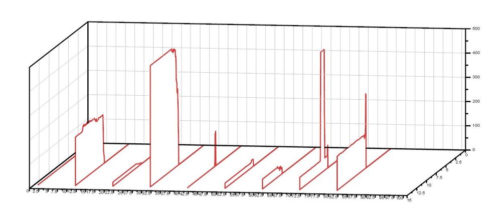

Hi there, I'm trying to create a 3D report graph , to display a number of Z channels against a common X channel, spaced along a Y channel. The waterfall chart below shows the result, but I want the channels to be in different colours to allow a indentification legend ( the waterfall option only allows for one colour trace option) . I'm sure there must be an easy solution, but cannot find it.
Any help would be appreciated.

In the 3D graph configuration, click on the red color you've selected, then choose instead of a color tile one of the words at the bottom of the pop-up selection dialog: "Palette" or "Glob. Palette 1", "Glob. Palette 2", "Glob. Palette 3".  Any of these will color the waveform planes each a different color.  You can then enable the "Color Legend" to show how those colors map to the Y values.
Note that you can also configure the waterfall graph to display planes in the perpendicular direction instead-- in your case that would be along X axis instead of the Y axis.

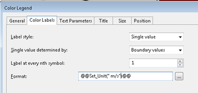

I am helping Adrian to implement this feature and I have had a look into using the User Commands as you have suggested by trying to alter the example from the Diadem help script.  I understand how the user command calls the function but I can't work out how to retrieve the channel names.  How would I change the function below to do this?
Function Set_Unit(TxT)
'Set_Unit = CStr( CurrFormatValue ) + TxT
Set_Unit = Data.Root.ChannelGroups(1).Channels.GetReference
End Function

Hi James,
I updated the application to pull the Z axis unit from the Zchannel of the 3D plot and append it to the end of the 3D color legend, using the UserComand and @@format approach you suggested.
See what you think,

Thanks for your answer it will solve the problem.  I think we will need the channel name displaying on the report but I will be able to construct that by using
SetLegendUnit = "Fuse" & CStr(CurrFormatValue) & " " & UnitStr
Thanks again,
