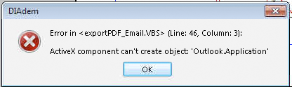

I have an interesting issue that I can't find a solution for. I am using the DIAdem Run Script.VI in Labview to call a script that opens an Outlook object and sends an email. When the script is called via LabView I get this error:
However, when I manually run the script from the DIAdem script tab it works as expected with no errors.

I found the issue, for some reason when Outlook is already open the script will NOT run correctly when called from the Labview VI but when it is called from the DIAdem script editor everything works fine even if Outlook is open. Maybe someone can shed some light on this? Has something do with creating an object that already exists?
