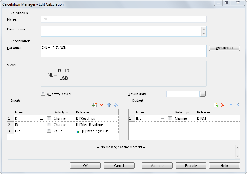

The Excel function that subtracts values within a column from each other can be replaced by the "Calculate Differences" function in DIAdem ANALYSIS (ANALYSIS > Basic Mathematics > Calculate Differences). That creates a new Channel I called "Delta" in my DIAdem Data Portal.
The next thing I did was add the LSB value as a property to a data channel (in my case I added it to "Readings" as a custom property).
The next step was to go to ANALYSIS and select the Calculation Manager from the toolbar. I added two calculations to the calculation manager, one for DNL and one for INL.
DNL
And here is the INL calculation:
INL
That's what got me the same results you have in Excel ...

Thank you Otmar,
That looks pretty straightforward.  Did you also calculation for the LSB from the readings,
and similarly for the Ideal Readings from this.  I'm still trying to perform these step.  The
calculate difference function is useful.
Mike

Hi Michael,
Otmar sent me his Calculation Manager files before he went home for the day in Germany.  I created a quick VBScript that loads the data from a TDMS file, calculates the Span and LSB properties and the Delta channel and then runs both Calculations.  Give this a try, then we should probably chat about how easiest to import your data into DIAdem.  Does your data start in Excel or does it start in an ASCII file that you load into Excel?
