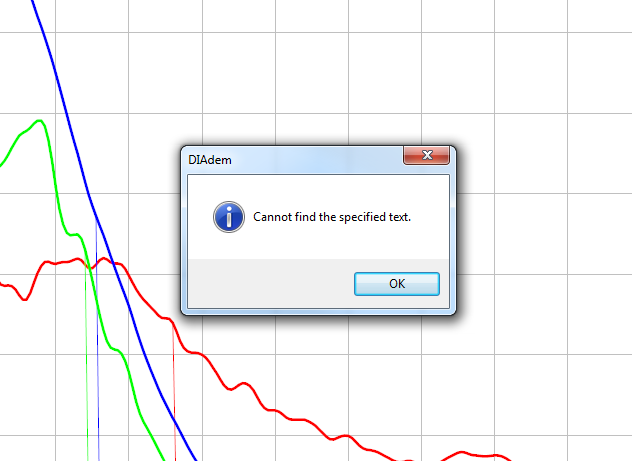

i would like to report a small bug. In script panel i mapped scripts on the quick run buttons in the left bar, so when i press a SHIFT key and F1-F12, it triggers a script. But when i run a script by pressing SHIFT + F3, after finishing the script, it opens a dialog for search. If i map a script on first position, i would expect opening a help (F1), after finishing of the script, but nope, nothings happen. so i think its a bug.
I attached an image to show u how my script ends after running it by pressing SHIFT + F3.
i spent some time searching for the warning in my code after i found out this behaviour, hope it will save time of other people

I think I finally understand why it is happening. It only happens when you use "Ctrl + F3" key shortcut in the DIAdem script editor when nothing is selected. This shortcut runs sort of quick search inside the active script and searches for the string that is actually selected. So for example if you will have the following script:
dog cat dog cat dog cat dog cat dog cat dog cat dog cat dog cat dog cat dog cat
And you will select "dog" + push the "Ctrl + F3" key shortcut your text selection will be jumping from one dog to another 🙂
On the other hand if nothing will be selected you'll get notification that null (empty expression) was not found.
I wouldn't consider it as a bug. What do you think?

I would not consider it as a feautre neither 🙂
i tried ur scenerio, and when selecting the string dog and serach for it and then run SHIFT+F3, after running the script, it jumpes to different search occurence. when i search someting that doesnt exists in the code, it triggers dialog.
i think its bug, cause your program should catch the shortcut SHIF+F3 which is assigned to trigger my personal script, and after that, it triggers classic search command. it should trigger nothing, so that why i call it bug

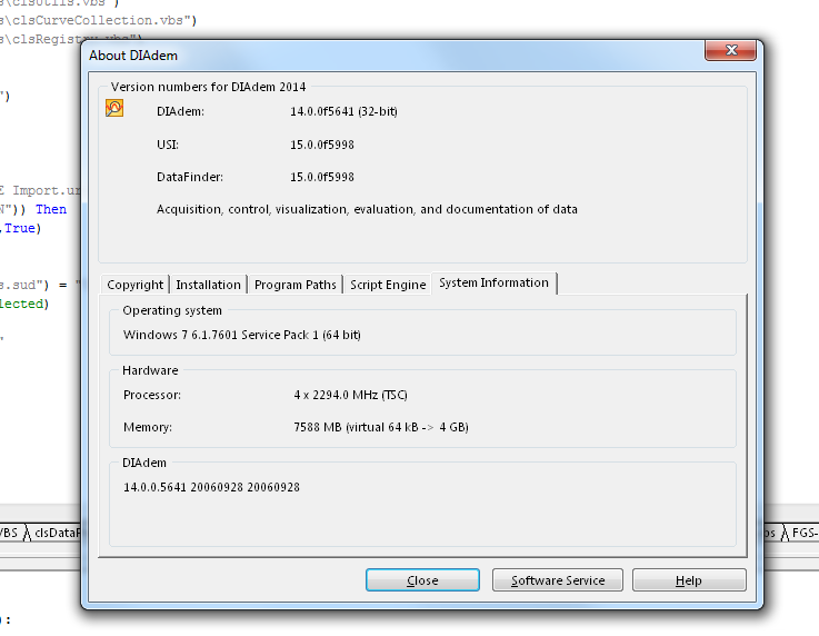

Dear Lukas.Doubek,
I cannot reproduce this behavior in DIAdem 15.0.0f6005 (32-bit). Can you please tell us the exact version of DIAdem that you are using (in Help > About...)? What OS you are using (version, service pack, 32b/64b, is it localized? what regional settigns you use?)?

diadem no localisation
win7 SP1 64bit localisation czech republic, hope it helps you
