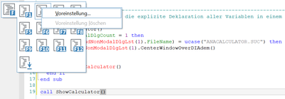

So that you can call the calculator directly from the user interface, you could place the script on a button on the script toolbar. To do this, right-click on the second (or third, or ...) button on the toolbar and select the first menu item. If you then enter the path and file name of the script file in the dialog, you can start the calculator via click on this button. The calculator will be centered over the main DIAdem window. The key combination Shift+F2 also works (for the second button, for the third it would be Shift+F3).
