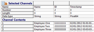

I start with a file that contains a group like this:
ExampleLog_Before
I run this code expecting the first row to be deleted

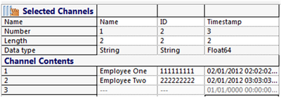

but end up with this:
ExampleLog_After
The first row of the Timestamp channel is deleted, but the Name and ID channels get their last rows deleted.
