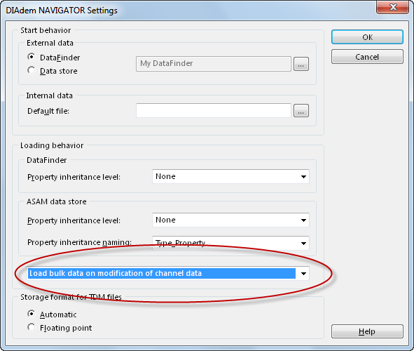

In the NAVIGATOR, go to the "Settings" menu:
In the dialog that will pop up, change the setting to "Always load bulk data"
Alternatively, you can also change this in the "General Settings: Compatibility" dialog, but I don't know what the difference between these two methods is.
Hope that helps, no need to go back to version 2010 after these changes. Oh, and don't forget to save your configuration file after you have made the changes to make them permanent!

Hello adek,
With DIAdem 2011 we provide different behaviors of loading bulk data. You can select it in the settings of DIAdem NAVIGATOR:
If you select the setting Always load bulk data, DIAdem loads the bulk data into the Data Portal on execution of the load command. In this mode, DIAdem behaves like in earlier versions when loading data. If, however, you select the setting Load bulk data on first access or Load bulk data on modification of channel data, DIAdem loads the bulk data when they are needed in DIAdem. Loading then starts either on first access of channel data or on first modification of channel data, depending on the selected setting. You can use these two settings to quickly load TDM and TDMS files with long numeric channels into the Data Portal, and view and edit the associated data in DIAdem.
For example, if you have lots of channels in your files, but you just need a few of them for your analysing and reports it often make sense to use one of the new loading behaviors to reduce your turnaround times. More information about this subject you find in the DIAdem online help.

I have also tried changing the "Load bulk data on modification of channel data" in the NAVIGATOR settings as well as "Always load bulk data" under the compatibility tab.
Neither of these changes have any effect to the data refresh performance.
