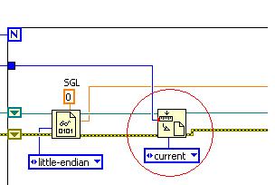

Hi Shahrukh,
The status bar and the error message often suggest a failure in loading last parts of channel values.
We can use Create DataPlugin Output File.vi to debug our code.
The data file appears to have 7 channels, each has 40282 data points. So I set Offset to 40280 and # Points per buffer to 2 and got error 4 " End of file encountered." in PB_Data.vi. Could it be one of the following reasons ?
1. Number of data points (waveform length) is not correct.
2. The file offset calculation is not correct.
Mavis

Update:  I found the faulty logic in my code, where I was reading x-1 points, thus the errors in Diadem.  Everything seems to be working well now.
Thanks for you help.
