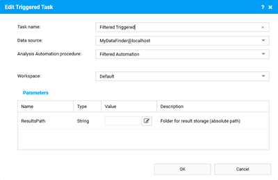

I put the same Analysis Automation Procedure in a Triggered Task and in a Manual Task (using the SystemLink TDM User Account):
When I add a file to the DataFinder Search Area, the Triggered Task starts running but produces an error. But when I put the same file in my Data Cart and run the Manual Task, there is no error:

Since 20.1 it is not sufficient to grant Windows administrator privileges to the SystemLink TDM user account. You also need to add execute query permissions in the SystemLink security WebUI.
Note: You will not see this application with your normal user account. This application is only visible to SystemLink Server administrators.
If you run the task with items in the DataCart no DataFinder query is executed from within the task. In this case the query has been executed before by you before you added the files to the DataCart.
When executing a task with Data Filtering enabled (and using a DataFinder as data source instead of DataCart) the DataFinder is always used/queried to get the list of files the tasks works on.
Are you already familiar with the new security web application and is it possible for you to figure out whether the SystemLink TDM account has been granted execute query priviliges in the Security application? Please let me know if you need more instructions here.

Hi Eva,
Thank you, you are a lifesaver! I used the Security web app to assign the "Data Maintainer" role to the SystemLink TDM User Account. The triggered task now runs successfully.
This is the crucial piece of information that I was missing. I thought that my SystemLink TDM User Account already had those permissions because I can use that account to log into Windows and execute queries via DIAdem. I didn't realize that permission to execute queries via DIAdem doesn't translate to permission to execute queries via the Analysis Automation instance.
