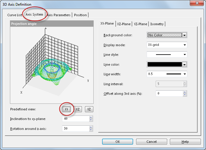

Step 3 - set the correct parameters for the 3D axis system display by double clicking into the axis system. In the dialog click on the "Axis System" tab and set the parameters as shown below:
