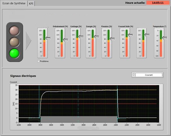

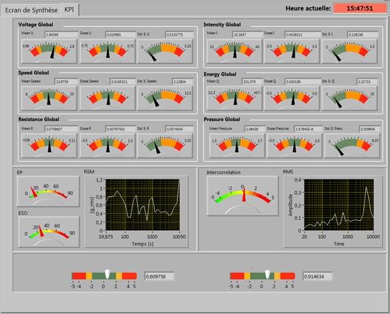

Hello ThiCop,
I've never used diadem before and what I want to do is to create reports automatically.
Currently I'm generating .doc reports with Report Generator Toolkit, making some "screenshots" of my front panel, but it is not very convenient to read...
The layout looks more professional with DIAdem.
Here is what my front panel looks like:
Thank you for your reply Smiley Happy

Hello Rafale,
Do you really want your Report to be an exact copy of your Front Panel?
Or do you just want a more fancy report than the one you currently have?
Do you use the current reports for the documentation of your provided code or rather to share measurements with other users?
Or in other words:
How would you want your report to look like in a perfect world where everything is possible? 😉

Hello ThiCop,
We use our current reports to share measurements with other users.
I'm not exactly searching for an exact copy of my front panel but a clear presentation of the measurements, with titles, text, insert some logos... etc. In other words a real layout. Smiley Happy
It would be nice to show the graphs of all the electrical signals ("signaux électriques" in french), display some values of the measurements, some go/nogo LEDs and gauges.
Thank you for you reply!

Yes I have the license (that is to say the company where I do my internship has the license)
I already try to playing around in the Report pane, but I don't find a way to display some gauges or LEDs, but just graphs and tables.
All I've done is manually create a report from .tdms files, and I don't use .tdms in my diagram... Smiley Frustrated

Hi rafale,
There are no gauges or leds in DIAdem REPORT, but it would be easy to include all the graphs from all the measured channels as you suggested.  You can color the number displayed in a textbox, or you coulde draw a mini-graph for each gauge result with the red and yellow thresholds displayed on it.  Another option would be to use error bars to show the in-range/out-of-range status of each gauge value.
Another option to consider would be to have a graph that covers a wide space left to right with multiple vertical bars (like a graphics equalizer for sound equipment), using a text label at the bottom of each vertical bar to display the gauge name for that bar.
Brad Turpin
DIAdem Product Support Engineer
