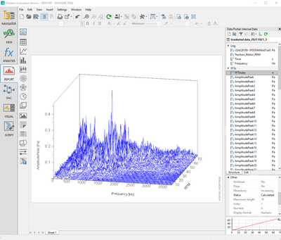

Got it!
The only issue now is getting the FFT index to corelate to RPM accurately.

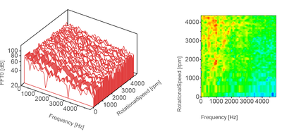

When I use the "Order analysis, frequency domain" though, I get several repeat FFTs, and strange scaling.
The best I have found is using the raw signal file. RMS and or filtering seems to give it hiccups.
There is some better correlation (single speed electric motor revving) when plotted on an overhead 2D, but a lot of the dB values, and choppyness of the FFTs makes me question that It's processing correctly.
