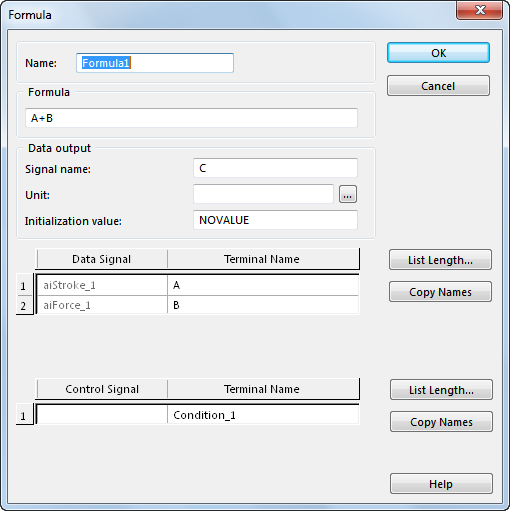

There is a block in DIAdem DAC called fx (in the "processing" section) that can perform online calculations:
Simply wire the signal you wish to process into this block, they can come from the same input block or from multiple different input blocks.
You can enter the formula you wish to use after double clicking on the fx block:
