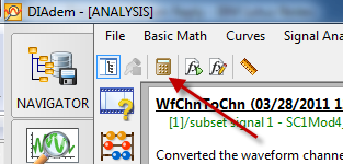

To round a data set, you will want to use the calculator
and use the Round operation or you could enter something similar to the following eqation into the top portion of the calculator:
Call FormulaCalc ("Ch('Group2/Result'):= Round ('Group1/Input')").

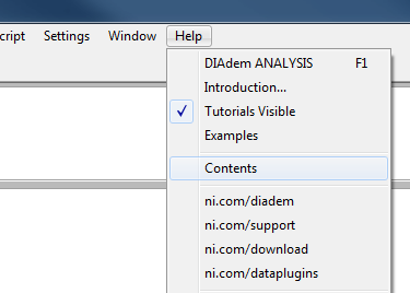

To find out more about the Round function, open Diadem and navigate to Help » Contents and search for "round"
Note: Double click any of the Operations (such as Round) or Channel Names to insert them into your equation.
